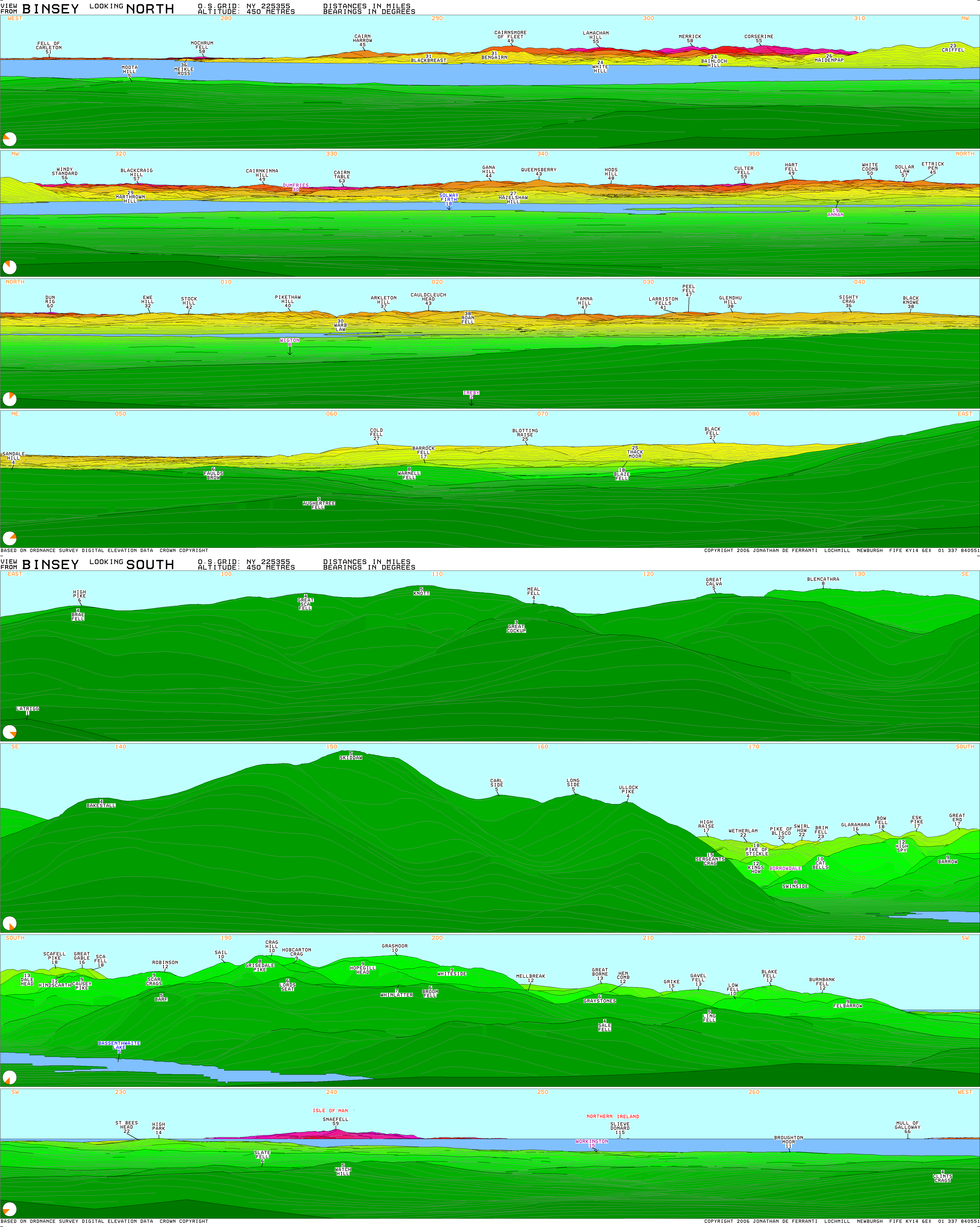

P.S. Any LOS summits that would work with Knott G/LD-023 or Binsey G/LD-041 next Sunday?
Sunday?
Well I was intending doing something up North in GM/CS-land assuming I didn’t need webbed feet. But I’ll have a butchers at the uniques down in GM/SS and see what looks promising. There’s a pair that are reasonable to do together that haven’t been on for years that may suit. I’ll also need to purloin John’s SOTAbeam again!

In reply to MM0FMF:
Andy,
It was just a thought - no pressure. If you decide to do a summit that offers LOS, then that’s fine. It might prove the X21 is okay or otherwise.

Well, the driving is about the same so it makes little difference TBH. The two nearby would make a decent amount of exercise and be worth 4 points which is the same as doing something bigger further north.
next Sunday?
Quite a few looking at Johnathon de Ferranti’s panorama site!
Knott:
Cairnharrow, Pibble Hill, Bengairn, Cairnsmore of Fleet, Lamachan Hill, Fell of Fleet, Merrick, Coreserine, Criffel, Cairnsmore of Carsphairn, The Cheviot, Sighty Crag, Peel Fell, Larriston Fell, Fanna Hill, Greatmoor Hill, Caldcleuch Head, Ellson Fell, Wisp Hill, Pikethaw Hill, Windlestraw Law, Dun Rig, Ettrick Pen, White Coombe, Hart Fell, Culter Fell, Tinto, Hods Hill, Quuensberry, Cairn Table (bleuch!), Cairnkinna Hill, Blackcraig Hill, Windy Standard
Binsey:
Cairnharrow, Bengairn, Cairnsmore of Fleet, Lamachan Hill, Merrick, Coresrine, Criffel, Ettrick Pen, White Coombe, Hart Fell, Culter Fell, Hods Hill, Quuensberry, Cairn Table (bleuch!), Cairnkinna Hill, Blackcraig Hill, Windy Standard, Sighty Crag, Peel Fell, Larriston Fell, Caldcleuch Head, Roan Fell, Pikethaw Hill, Dun Rig
Have you got a rough idea of when you expect to be on the summits and I can look into being QRV at the same time?

In reply to MM0FMF:
… and they say these summits may be hard to qualify on VHF!
I’ve posted the alerts for the next sortie. Knott might be a tad early for you, but it offers slightly more options. Perhaps you were looking at two possible skeds - could be interesting!
