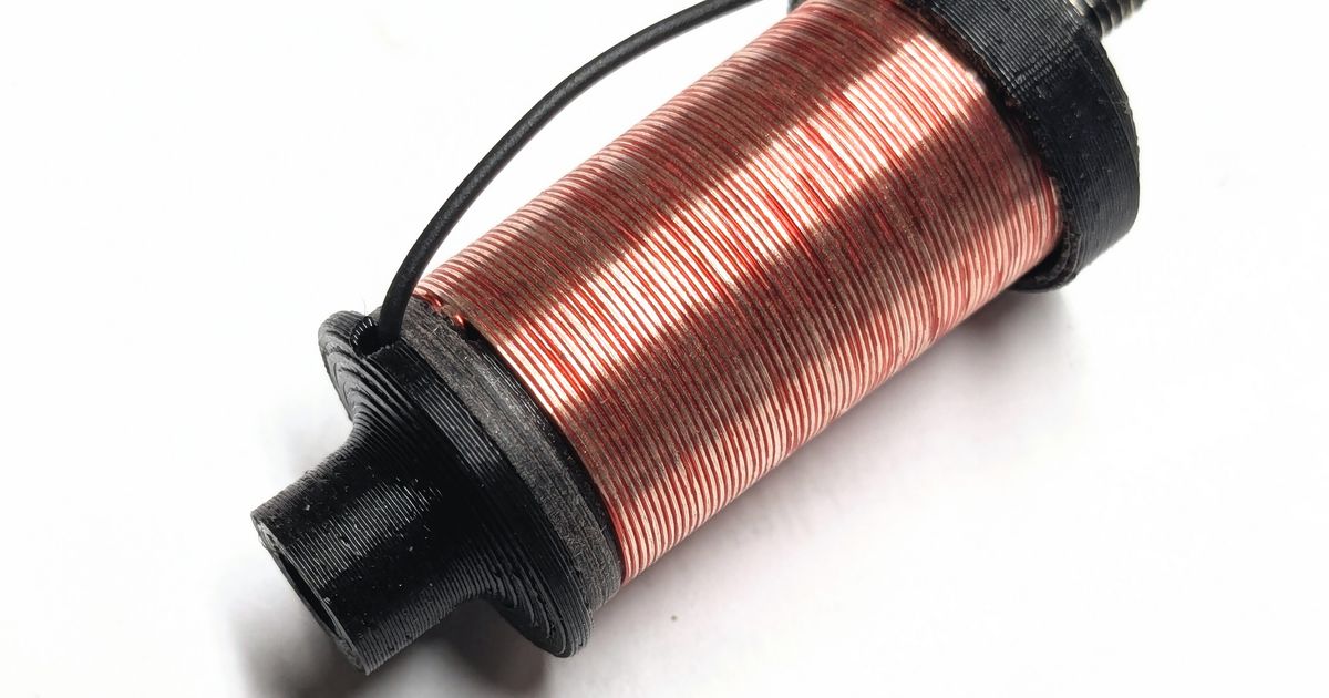

Adam @K6ARK has published a tiny variable loading coil for adding 30+40m to the KH1 4ft whip antenna:
I built one and it works well, although the efficiency of a 4ft vertical on 40m is probably best described as ‘for emergency use only’ :grinning:
However, it showed promise on 30m so I reused Adam’s STL files to make a fixed loading coil for 30m. I used 38 turns of 22awg wire for 12uH which works well on 30m with the KH1:
Testing in my garden the other day I was getting good RBN spots around Europe and chased @HB9DGV on 30m with the 4ft whip and 33ft counterpoise, Rolf gave me a 579. So I think this is quite usable to add 30m to my ultra light kit. Now just need to fully recover from recent surgery so I can get back out on a hill again!

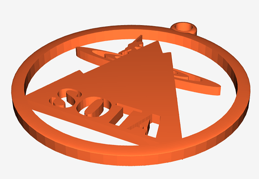

I use https://www.tinkercad.com. Of course it’s not a fully blown CAD software but works well for lazy people like me who need to design fairly simple stuff quickly and don’t want to learn a complex tool. For example I designed my Pocket Transmatch cover and the SOTA ornament with it:

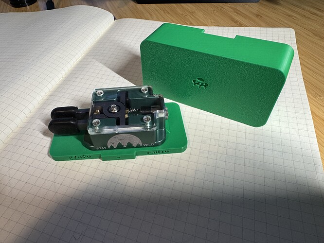

Anyway, this is my offering to this thread, a case for the BaMaTech TP-III paddle.
All the designs and details are here.

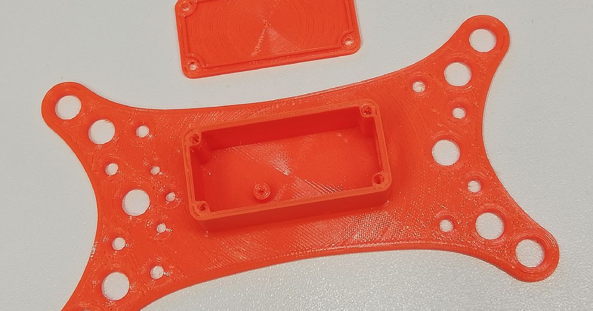

I received the printer and after the traditional test print “benchy”, I printed my first object:
The print is good. Little imperfection in the hole for the BNC connector because I ignored the overhang. If I need to print another one I will add supports for this.
I’m waiting for heat inserts, screws and banana inserts to finish and test the project. So far, I tested the coil and as planed, it goes from 0 to 20 uH.

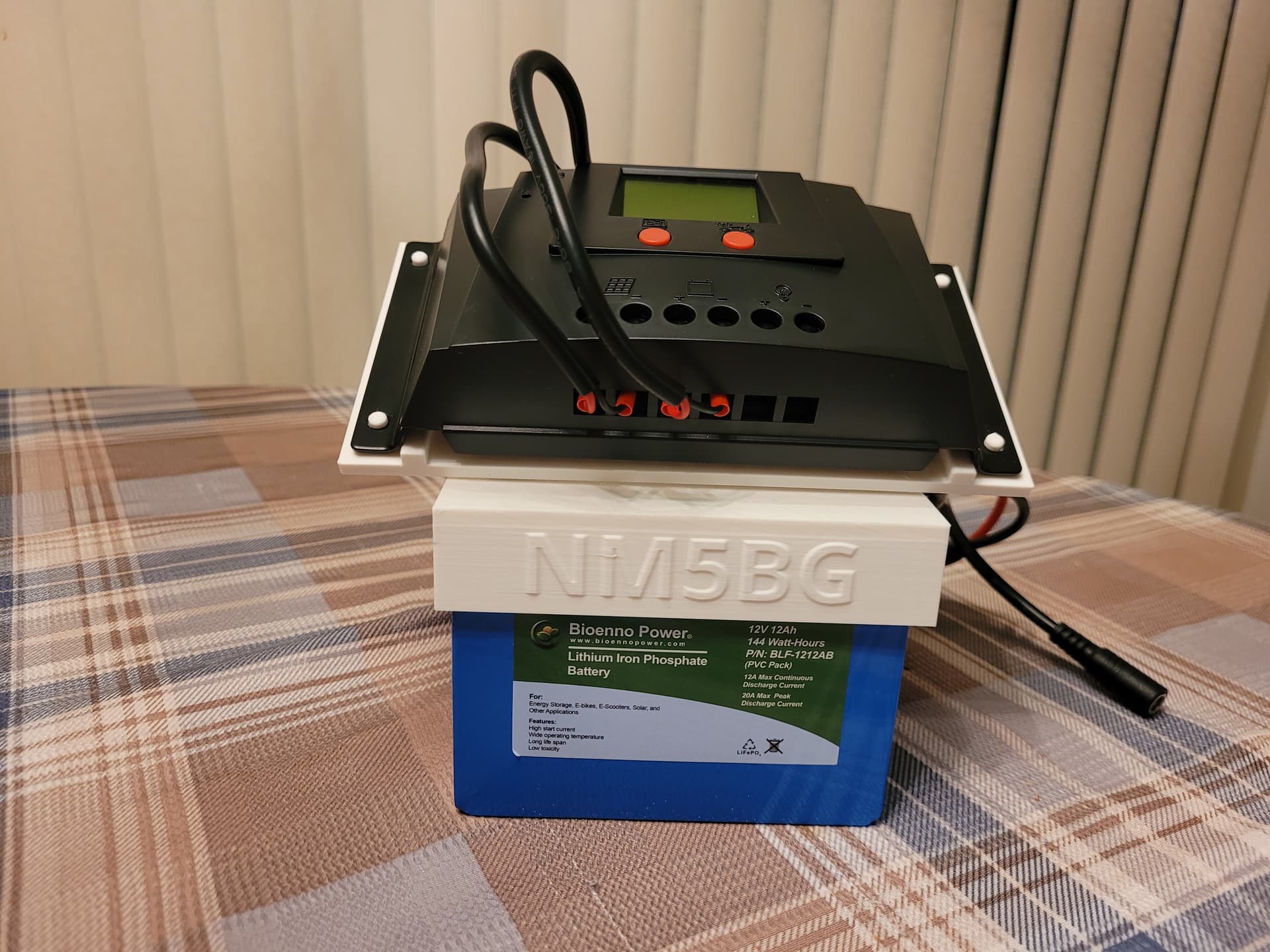

I used onshape to design a holder for my solar charge controller on top of the battery. I typically use this for longer POTA activations with my solar panel. That battery has always been charged with solar exclusively.
The 4 posts, the battery cover, and the charge controller holder were printed separately and assembled with just friction fit.
73, Brian, NM5BG
