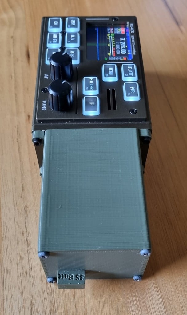

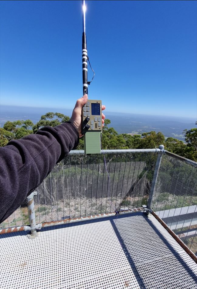

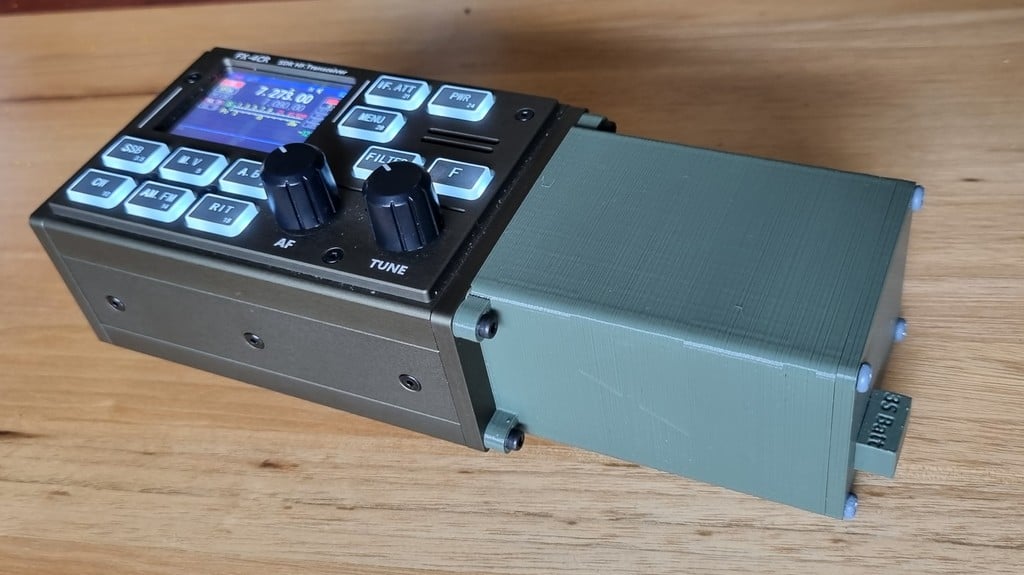

Here is a 3d printed battery box for the FX-4CR radio. With this screwed on to the radio I can use it like a hand held. Inside there is a 3 cell 18650 holder with fuse. A cell balance socket is fitted to the case so it can be charged by a balance charger. It’s a bit of a work in progress.

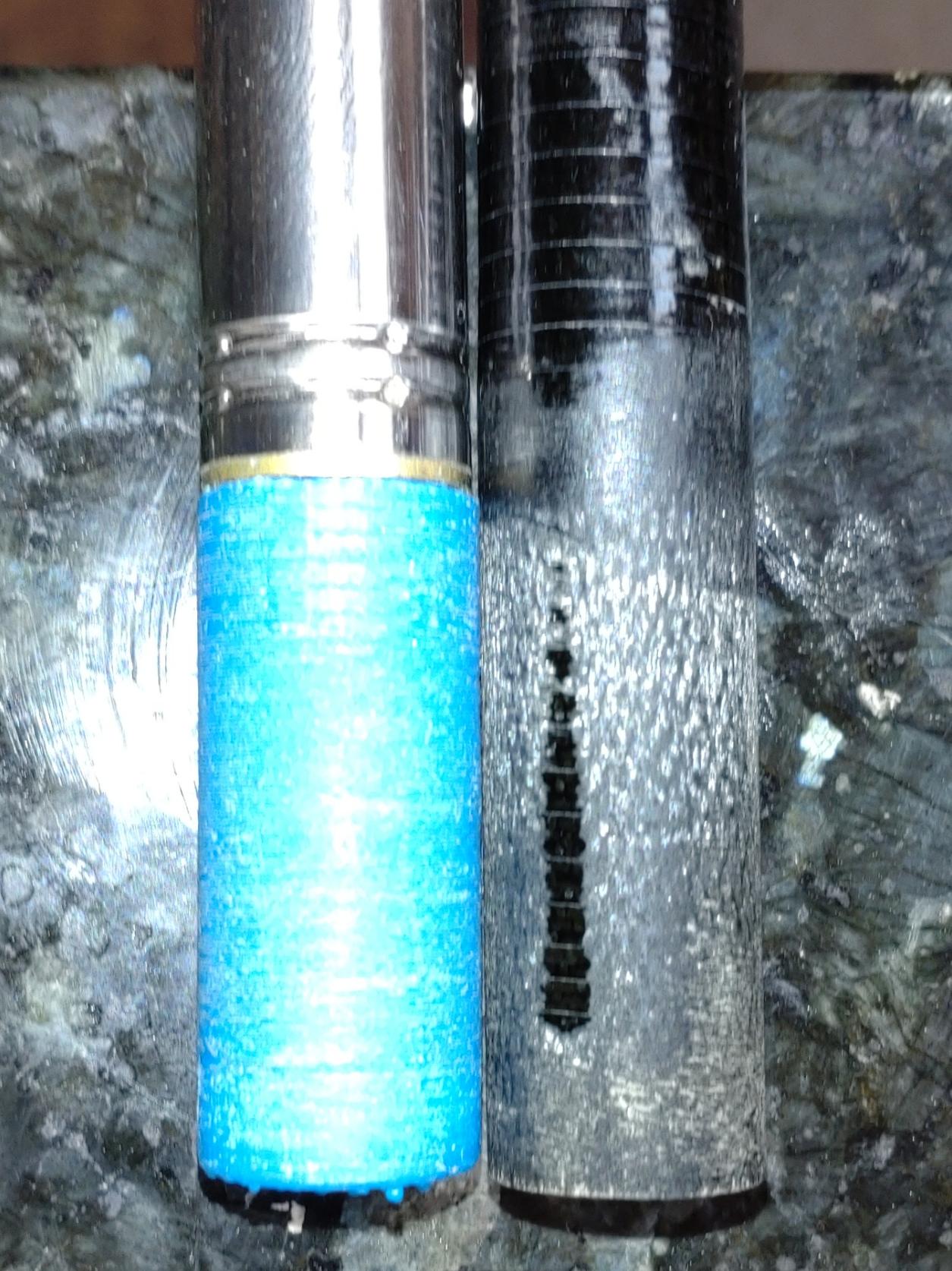

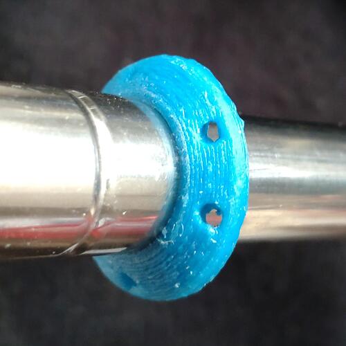

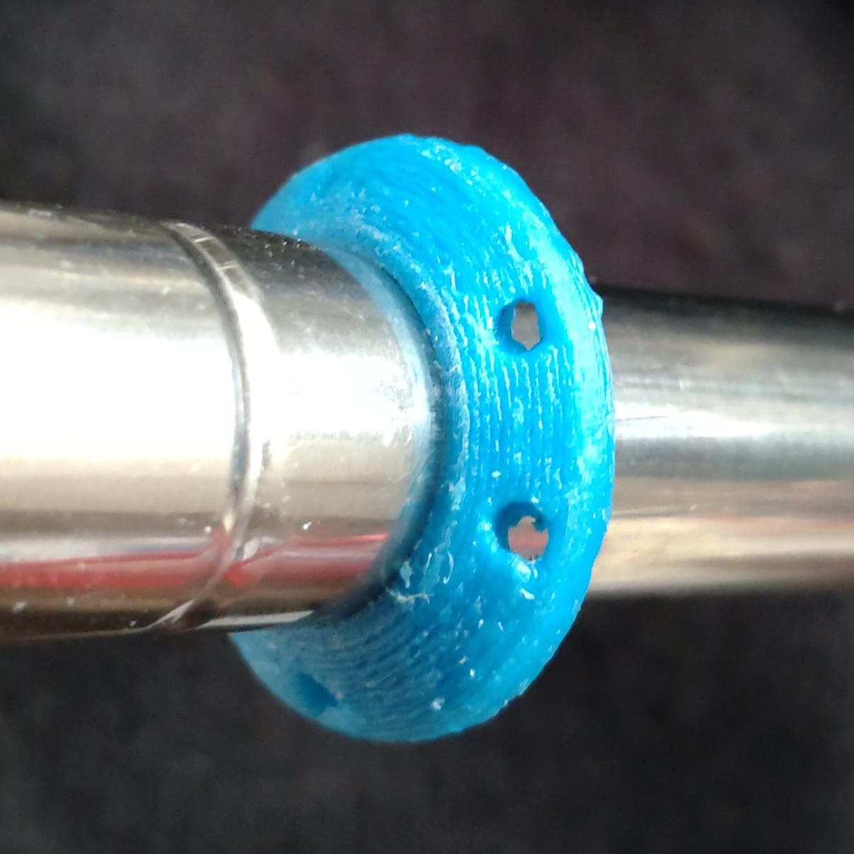

Adaptor to put 5.6m Whip inside the Aliexpress SOTA pole / perch pole
Brings the total length to 7.8m
See details on:

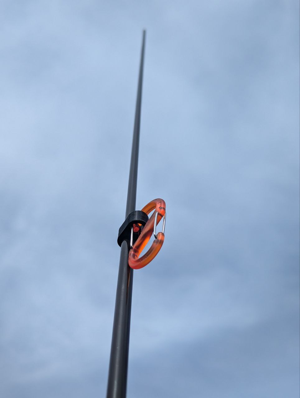

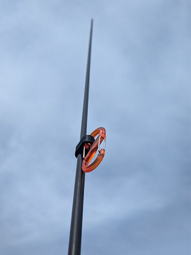

A very smple hook for the SOTA Beam Tactical Mini I made to allow for easy attachment of antennas too the mast
SOTA Beam Tactical Mini Loop Hook

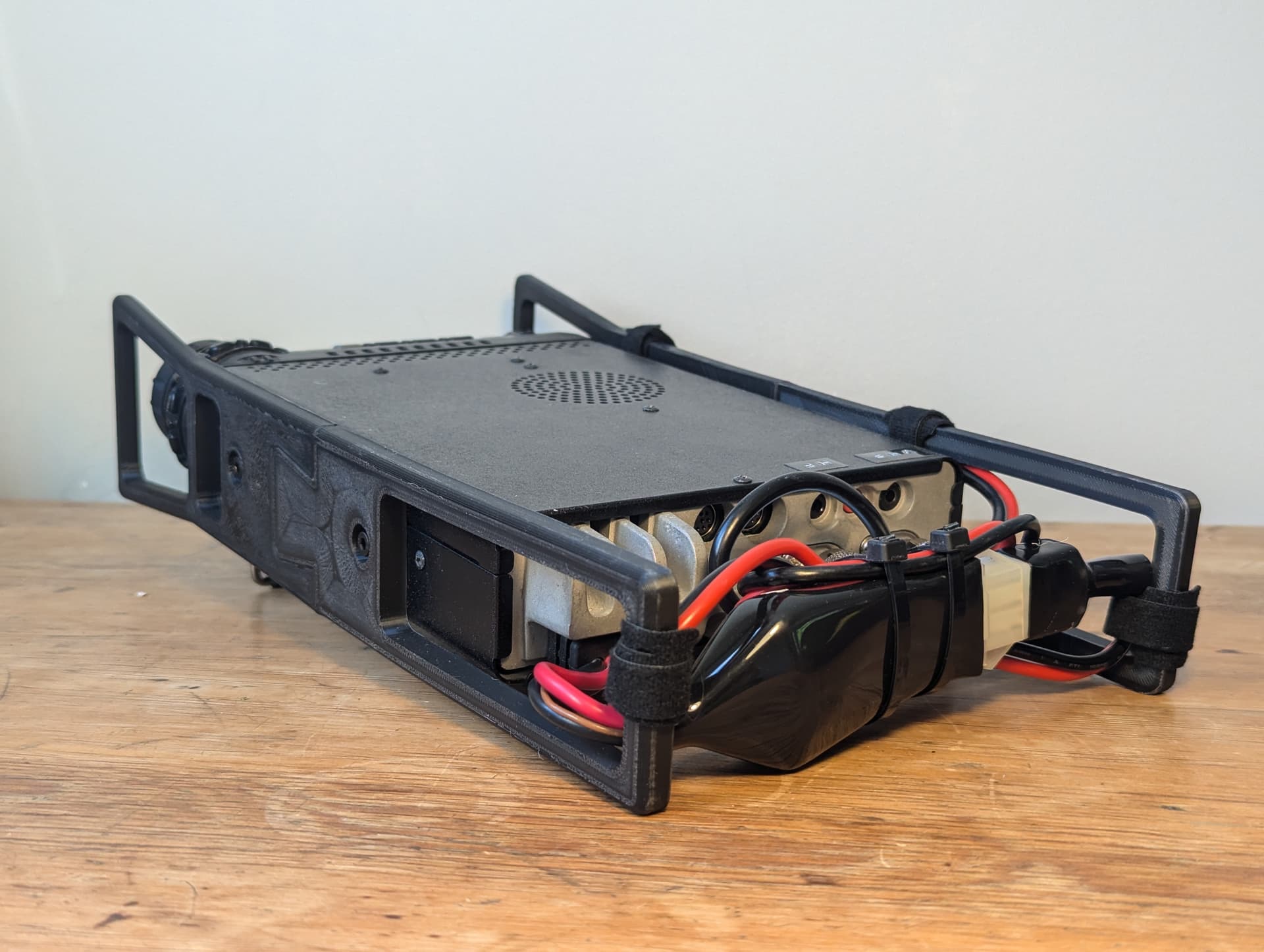

Yaesu FT-857D Side Rails Remix (link)
An adaptation of ‘SurfinBirdmans’ rails for the Yaesu-857 which adds a 5cm extension to the rear of the radio to provide more space for cable management, useful if being stored vertically in a backpack on activations.

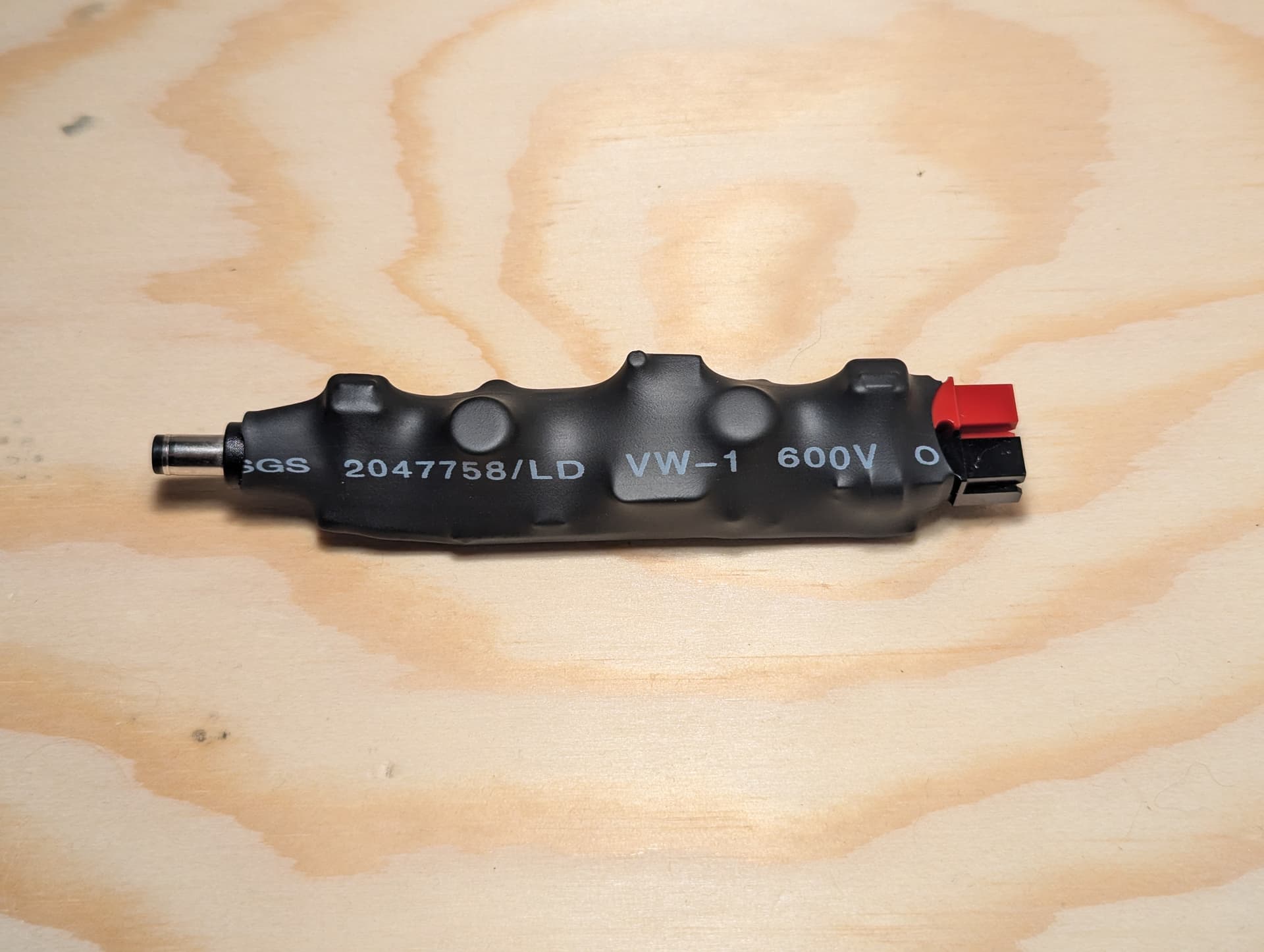

Buck Converter Backplane HW-411 (link)
A striaghtforward backplane for a HW-411 buck converter, which allows it to be securly attached to the connectors at each end, ruggerdizing it as I use it on SOTA activations to step down the voltage from my battery to my Yaesu FT-818ND and FT-857.

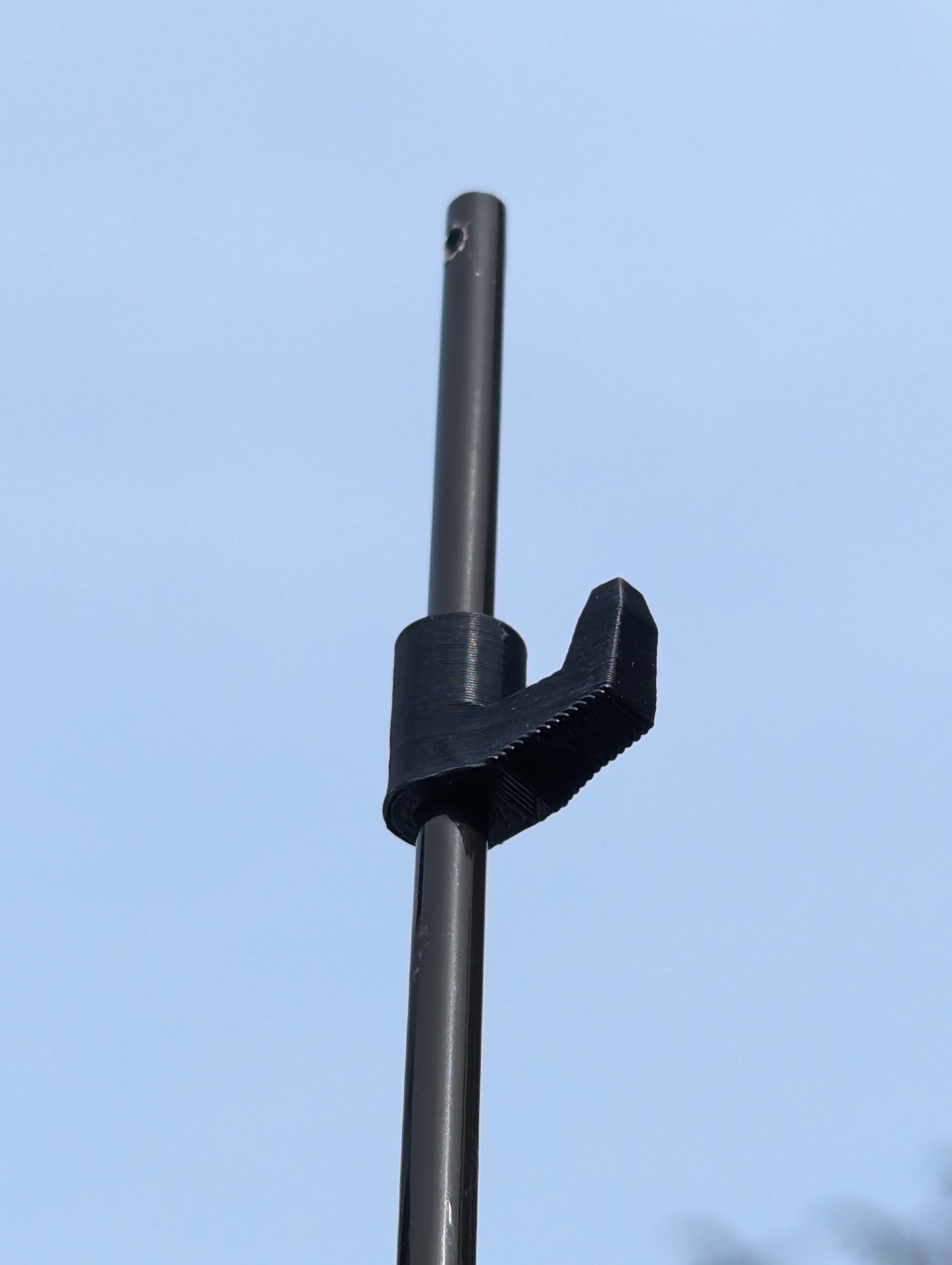

SOTA Beam Tactical Mini Hook (link)
Another simple hook I’ve designed to attach to the top section of the SOTA beam tactical mini, if reversed doubles as a hook for ‘fishing’ cables/wire.

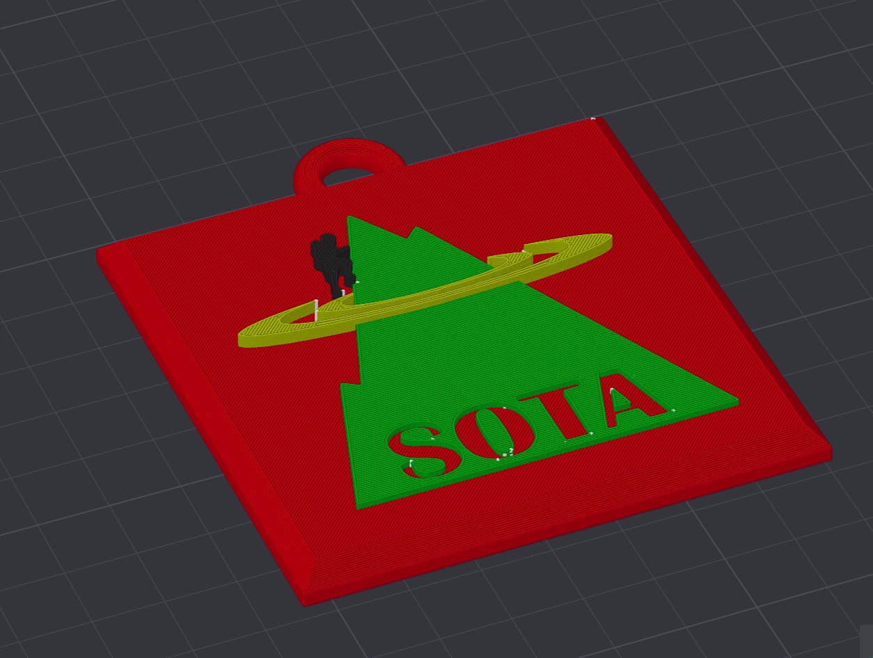

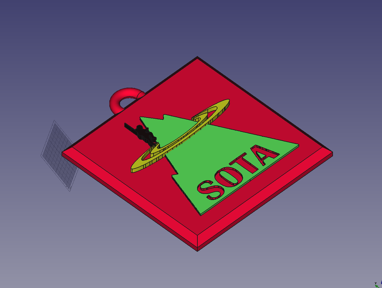

To get everyone into the Christmas spirit… I spent some time this evening on a SOTA Bauble now on Printables and MakerWorld…
Just ordering some of the right colours to print one up. So that i can add a picture of this on my Christmas tree !
The logo will also be good for embossing parts. If anyone is interested, DM me, I have FreeCAD CAD files…

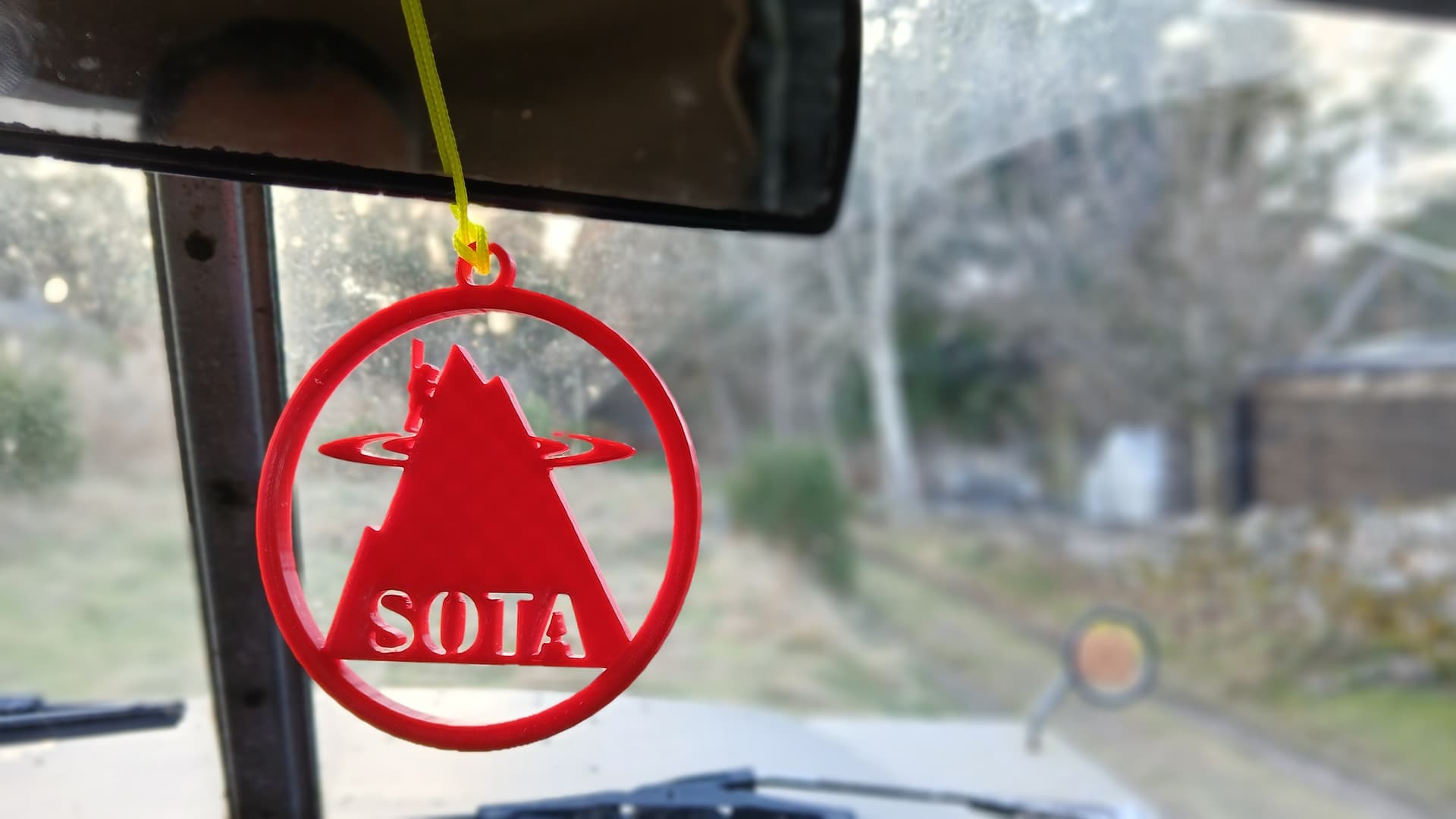

Thank you @GM5ALX Alex for the mirror ornament.
I’m about to place it on the Christmas tree and see how long it takes Mo to notice. :evergreen_tree::gift::santa:
Ho ho ho my very own design on printables :christmas_tree:
There’s been only 18 downloads since it was published 2 years ago; I am glad to see it printed and shared :innocent:
You got here before I did! Yes, thank you for the design - I just searched SOTA to see what people had made and spotted it! :christmas_tree:
About 4 hours was the answer. She came marching across to the bothy with it. I think my error was hanging it around the angels neck.
