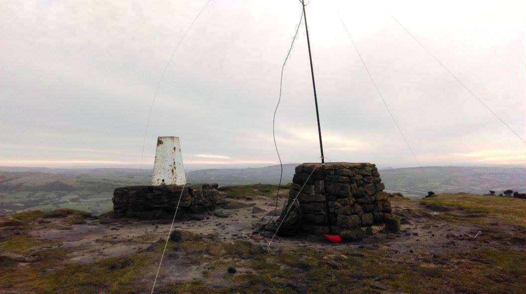

I was first into the parking spots at Cloudside, and the first walker up on the summit. It would get steadily busier throughout the morning though, reaching levels of between 50 and 100 up there at some points. I set up Jimmy’s SOTAbeams MFD mounted vertically at 5m on a SOTA Pole. It was extremely cold, so I commenced the activation inside the bothy bag, which made things very much more comfortable.
