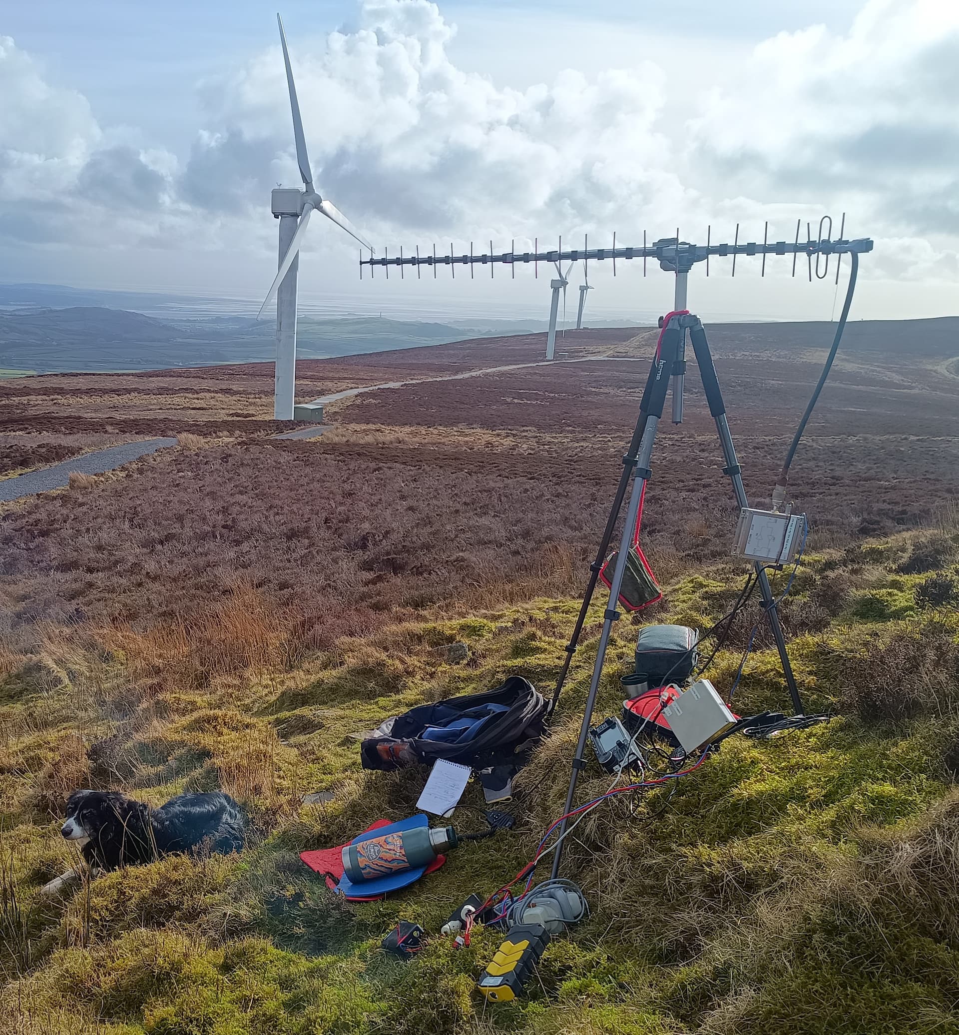

What a cracking day today. I saw M0JKS had posted for 23cm from a summit, seeing I’m always keen for a 23cm QSO and had not managed a S2S on that band I was really up for it.
I set off for the summit with my wife, but at the summit she carried on walking the dogs and left me to it.
I soon set up, but found the power lead for the IC-705 was damaged, luckily I had the high capacity battery fitted and it was 2/3 charged. I also found I had left a coax adapter out of my kit, but luckily I had a spare patch lead that I used instead, so the configuration was not as expected, but it all seemed to work OK.
Kit was IC-705, Two LiPo batteries ( I took a spare this time and needed them both too). SG-Labs 23cm Transverter, SG-Labs 25w amplifier, Tonna 23ele on a camera tripod.
The first call was on SSB at 10:52 and I worked Roger G3OHH and received a 5/6 with him, he was 5/9 with me.
Then Ross G6GVI at 11:02, 5/2 both ways, which was pretty good and I didn’t notice any multipath distortion either this time.

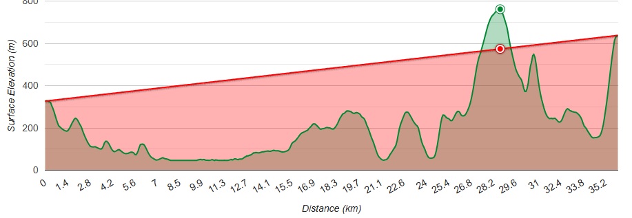

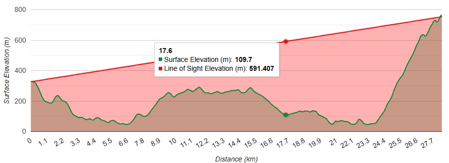

The sleuths among you might have deduced which summit from Nick’s APRS tracker trail.
Quite surprising there was not as much rock in the way as you might expect, the LOS managed to miss a lot of it.
The high spot on the profile is the ridge between Hart Crag and High Pike, just west of Red Screes.
Today your signal would go from 5/9 to 0/0 :slight_smile: I guess as you moved around, so the signal had a very small path to get through all that rock ?

Seeing Dave M0JKS was planning to be out on Red Screes today and taking his Alinco 23cm handheld radio, I decided to do Kirkby Moor G/LD-049 again and see if I could work him for another Summit to Summit QSO.
Again I was accompanied with my wife and our two dogs. About 2mins away form the summit I heard Dave calling me on 23cm as I had my Alinco on 1297.500 on the way up. I let him know I was almost there and he had a cup of coffee while I finished the last part of the ascent.
When I got to the cairn we easily worked at 5/9 both ways. The interesting thing was Dave also worked Dave GW8TBY at 5/9 and I couldn’t hear TBY, very strange, I guess the extra height JKS had was part of it. The pressure today was around 1040mb, so I wonder if there was a high level duct between them.
I then set up my kit, IC705, SG-Labs Transverter , SG-Labs amplifier (25w) and Tonna 23ele on the camera tripod. I put a few calls out on FM, but there were no takers.
I went on to SSB and easily worked Dave GW8TBY, he said I was the strongest signal he ever heard on 23cm and got a report of 5/9 +60.
