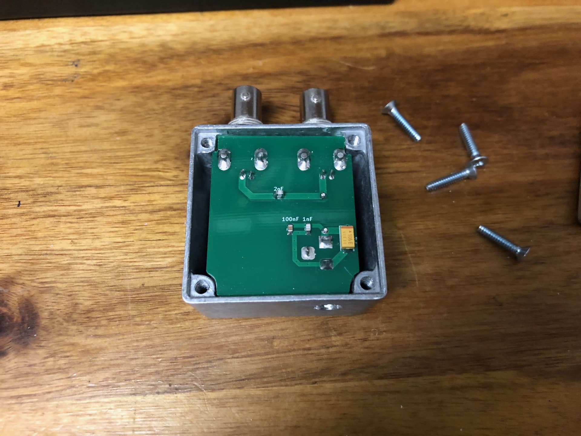

I also have the SG-Lab 23cm transverter. It’s a well thought out design with a few options for DC power and tx switching. I’ve just built a small simple bias-tee so I can power mine through the coax for portable operation, the idea is to mount the transverter on the Yagi boom. I’m presently building a 14dBi gain 9 ele, the overall length with transverter will be 70cm.
