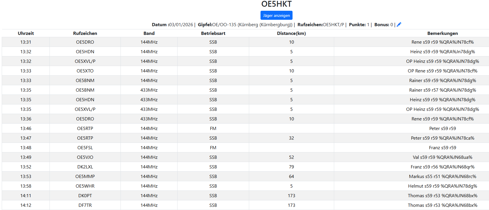

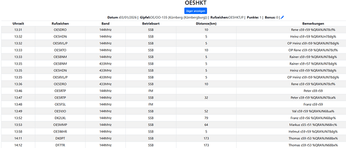

Thanks a lot for the challenge. I have a question. How is this scored? Uniqe call per summit oder per band?
I think in my case, alle QSO`s where scored, is this correct?
73, de Michael OE5HKT

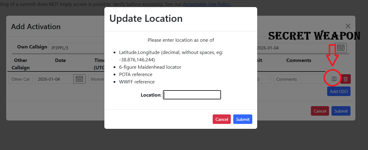

I’m terrible when it comes to software and anything related to computers. That’s why the more I read about questions, answers, explanations… explanations and even more explanations about how to upload the challenge logs, I confess I went into a kind of panic (or maybe it’s better to call it anxiety…).
Today I did my first activation of the year, JA/HG-243, and I combined it with the U/VHF Challenge. It didn’t turn out the way I expected, but at least I got my first points for this Challenge.
And uploading the log was the complete opposite of everything I had been reading—simply simple and easy.
I hope that during 2026 I can bring the same enthusiasm I had for the “10 Meters Challenge.”
73 de JP3PPL

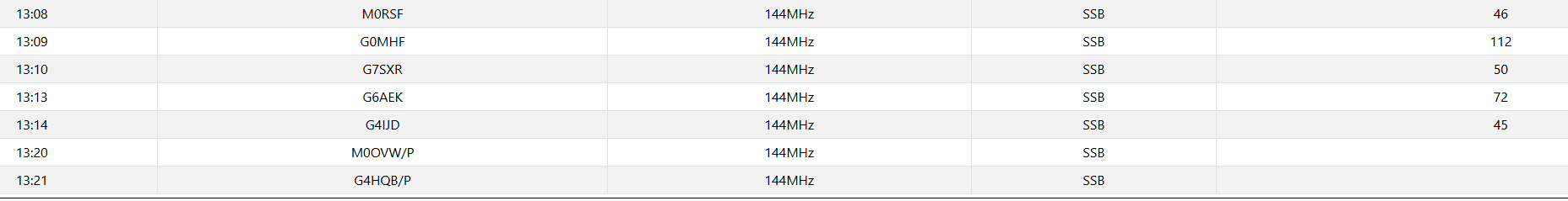

Unfortunately it still doesn’t seem to work for me. Here are my 2m SSB contacts in my activator log details page for today’s activation of G/NP-008:
The relevant S2S log:
I would have expected the 200km to appear against both contacts in the details page.
My challenge activator score:
The distance includes that from my previous activation so it clearly isn’t giving credit for the S2S contacts today either.
I tried that with the first activation and it made no difference.

I’ve spotted the issue - I had to impersonate you and then step through the log line by line to see where it was tripping up. I’m back at work today so I will push a fix in between the mountains of email.
Cheers,
Andrew
The 5x10⁶ posts on this topic are inversely proportional to my desire to take part.
How faintly ironic.
This is live now. For S2S uploads that aren’t counted, edit the upload, verify and resubmit and it should score correctly now (modulo some other edge case)
