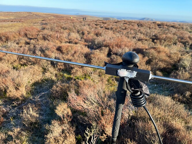

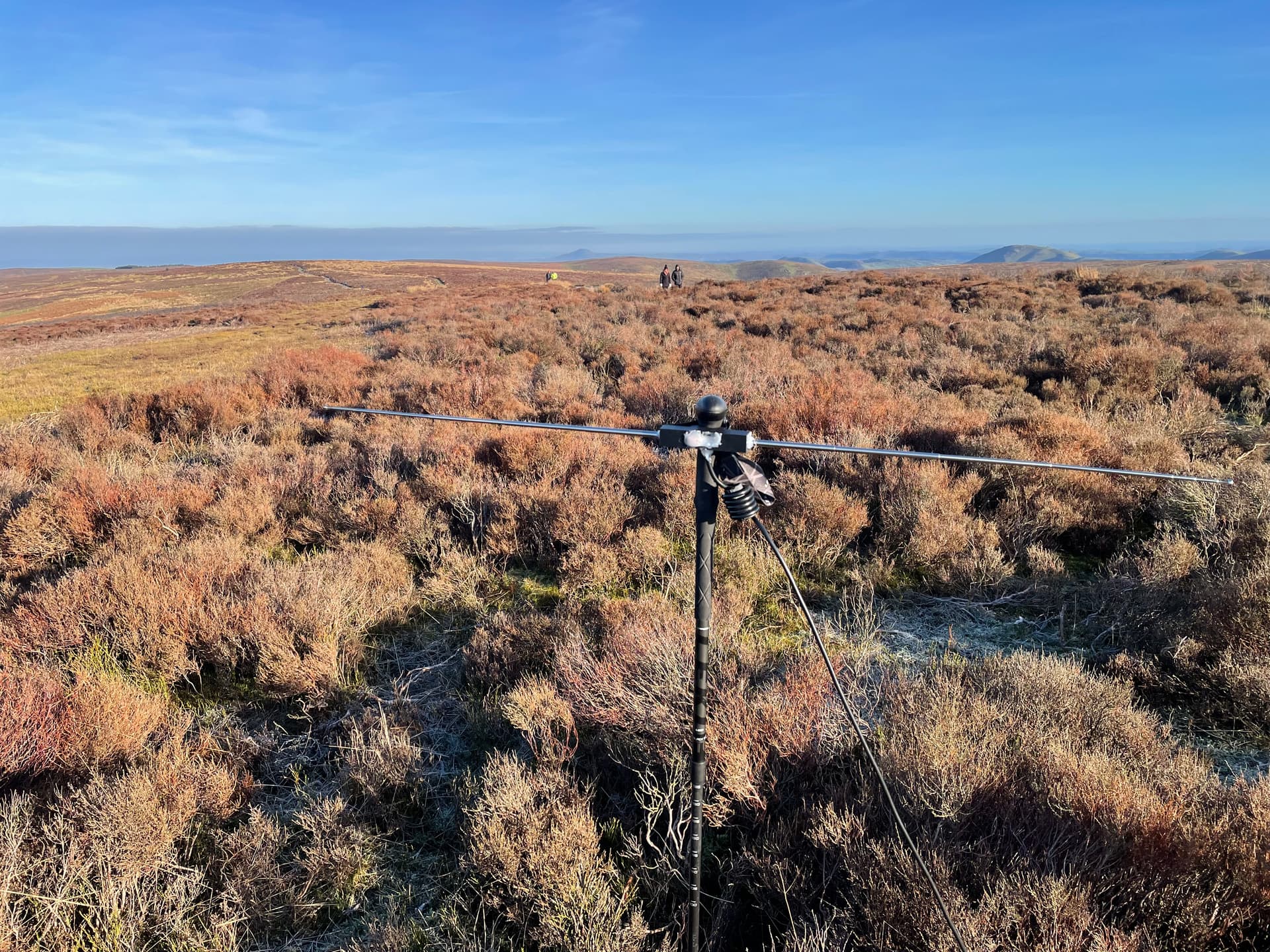

Keeping it simple, I made a half wave dipole for the challenge. It is designed to fit a walking pole, or other pole. Cost me £5 to make, that was for the telescopic elements. A bit of 3D printing, and I had some Hyperflex 5 and felcro strap in stock. It folds down to about 300mm.
Gave it a quick test on G/WB-005 today seemed to work ok.
Note to self, keep the coax vertical :joy:
..hi Paul, looks great, very creative!
How did it go on bands?

Ok for a first test, but it needs more testing. I only had 3 SOTA QSO’s, I think two of them were at the same location and were very weak. I could hear a non SOTA station 59 when tuning through the band. I was amazed to start getting some QRM from another station causing me to move a few kHz

What frequency were you operating on initially?
I was on 144.288
