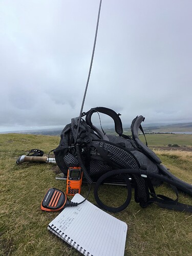

Thanks to you all for the advice and guidance. I had to ignore the call to get a quality HT but went for a Quansheng UV-K6 at £21 and £9 for the additional aerial. I deliberately went for orange so I couldn’t lose it if I set it down somewhere. Seemed to work well. I spent yesterday getting the relevant freqs saved so I could be relatively agile changing frees and it all worked out. It was bloody windy on top of East Lomond today but I got into central Edinburgh and Falkirk. I settled for 4 QSO’s in the 45mins I was there, I was interested in seeing if I could do a POTA activation at the same time but there just wasn’t much responses.
