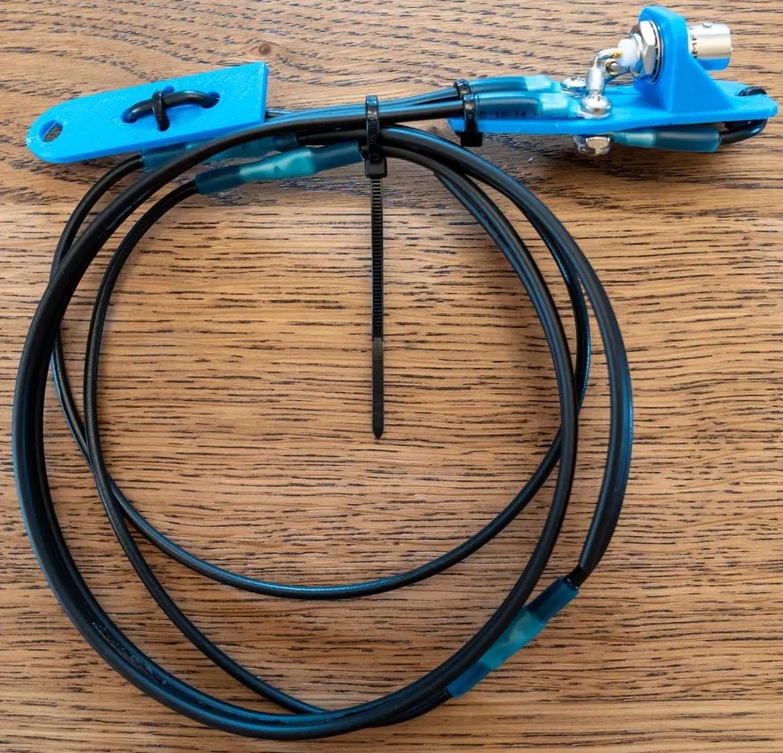

I have been looking for a suitable 2/70 antenna, saw this J pole, unfortunately, this one comes in at around £23.00, but with shipping from the States over double the price! I will see if there are any 3D plans for it!

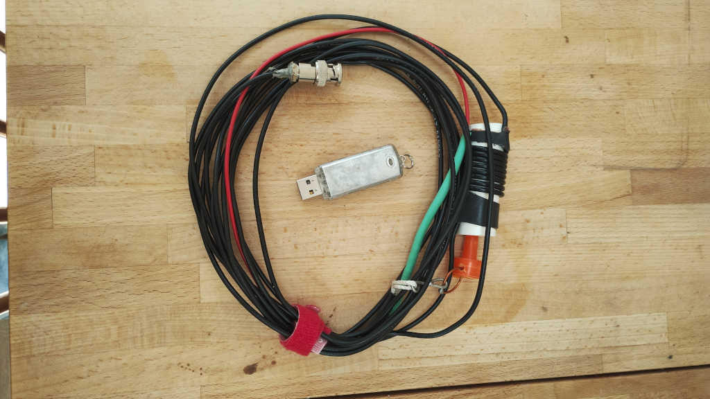

And… make a Flowerpot instead. My 2m Flowerpot took 45mins to make and is much more tolerant of nearby stuff than my J-pole and works exceptionally well on 70cm. A bit of wire, a bit of scrap RG-174, a PVC overlow pipe cutoff and a plug. Simples!

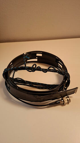

Buy a few meters of 300-ohm or 450-ohm ladder line; you can find many online calculators for the lengths of the sections. I recommend the Slim Jim instead of the J-pole. As soon as I have time, I’ll send you the measurements of mine for 2 meters.

2m Flowerpot with 5m feeder, rolled up with USB memory stick for scale.

Easy to build and roll up. Part cost of 12 Euros or so.

They say it’s for 144 to 146, but I’m not looking to buy because of postage. I’m interested in making one, but obviously getting the required bits 3D printed

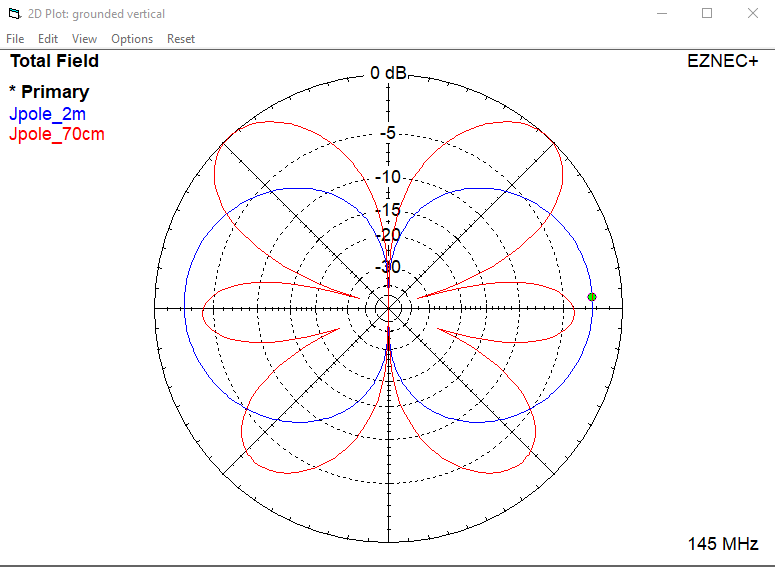

A standard 2m J-pole (the Slim-JIM is just a variant with no significant difference in performance) is a half wave radiator - basically a dipole. On 70cm it is a 3/2 wave radiator. The radiation patterns look like this: 2m is blue, 70cm is red.
When the antenna is perfectly vertical, the signal on 70cm is less than 2 dB down from a dipole. But if the antenna blows in the wind, or the pole leans, so it is 15 to 20 degrees off vertical, then the signal can drop significantly in some directions due to the nulls in the vertical pattern.
There are several ways to improve the pattern on 70cm, and several attempts to do so that don’t actually work very well.
