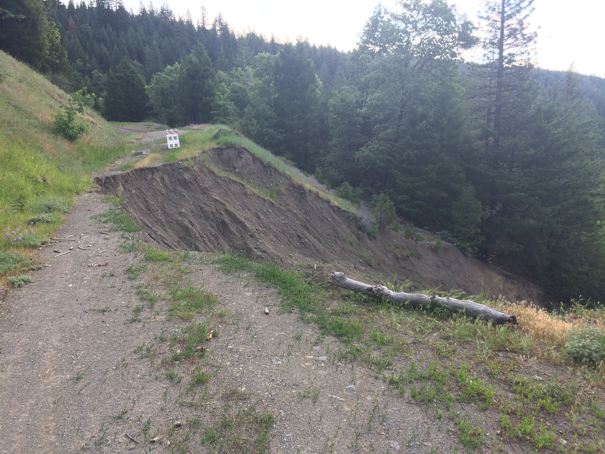

On my first attempt at a 6 pointer I ran into this washed out road, I went back another day better prepared to navigate my way around problems. Hang in there and have great radio fun!
