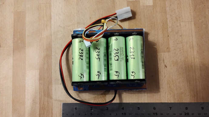

I try to keep on top of what is available. I’ve made packs out of 3x 18650 LiPos, these cells are easy to obtain. Remember the very high capacity cells are probably ā€œoptimisticā€ regarding capacity. i.e. it’s a lie! I think more than 2500mAh per cell is probably not happening no matter what it claims.
I did buy a number of surplus 26650 LiFePo4 cells. They were nominally 2500mAh but these were older and running around 2300mAh. They were ex e-bike packs so can provide 50A (but not for that long) so they are heavy but a number of activators in the Edinburgh area have them working. A 26650 battery holder and BMS lead was a few pounds.
Here’s the prototype. I used it recently on GM/NS-117
