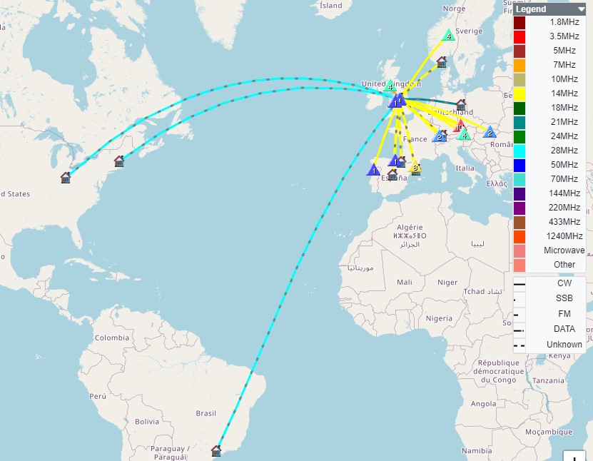

38 QSO in total in an odd symetry of. 19 Summit to Summit - 19 Non summit to summit over 19 DXCC. 34 on HF (various bands) SSB and 4 on 2m FM. Map below
