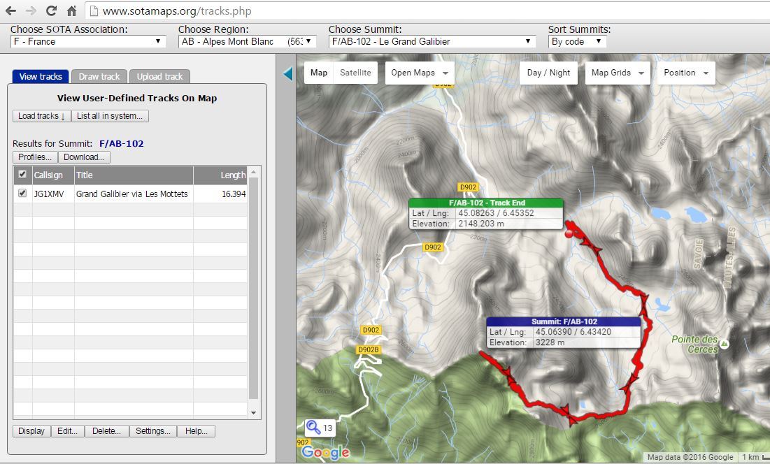

Good work, uploading GPS tracks to Sota is something I would do if I knew how to. Such tracks can be quite handy for others.
The interface to do so on sotamaps.org is fairly easy to use. I recommend people to have a look. You can post your gps track along with comments to help people to get there. I also like the feel of the entire sotamaps.org site from a GUI perspective. It is a very well built and useful tool.
Hi Nick,
uploading a gpx-track to SMP is not too difficult. Just have a look at http://sotamaps.org/about.php and scroll down to “TRACKS MAPPING PAGE”. There are some help-files to find out how to upload tracks.
I uploaded about 100 tracks mostly of OE/OO-Region to SMP. So it is easier for other people to find the right way to the summit. If I need to edit my gpx-track before uploading I use Home - GPS-Track-Analyse.NET … this one is in German, but I’m sure there is similar software available in english also.

Sometimes, the starting point of a track is even more important than the path details up to the summit: For activators not familiar with the area it is extremely helpful to know how far you’re allowed to drive and where to park your car.

I think Rob prefers that you upload one-way tracks when it’s a straight up-and-down, so typically that means a bit of gpx editing. A nice free editor is Viking. I use this for illustrating trip reports too, with the map set to Open Cycle Map.
If you want to link directly to a summit’s tracks page you can construct a URL like this:
http://www.sotamaps.org/tracks.php?smt=F/AB-102

Another nice GPX editor is at http://www.gpstrackeditor.com/
A clever feature of this one is that it can automatically colour sections of the track by various criteria, one of which is speed. If, like me, you record the entire outing in a single track, this makes it much easier to separate the driving from the walking visually.

I do indeed - although it has to be said that this requirement is not so vitally important these days as it used to be, since the introduction a few months back of a track-points reduction algorithm in the tracks uploading section.
There still remains, however, the stringent requirement that (powered-vehicle-) driving sections in the GPX tracks be removed before uploading tracks. I’ve not looked at any uploaded tracks for a few months now, having been busy with one thing or another, and was this very evening astonished to find 16 tracks from one particular author with track lengths of 50, 60, 120, up to 174 km, and in all with a total of over 830 km length! These I have edited down to a mere 32 km in total, representing just the hiking sections: the author has been duly notified, and requested to adhere to the requirements as set out in the “Upload tracks” help section (there is a “Help” button thoughtfully provided for the purpose of viewing said help section )

If you’re good at looking at a map and remembering where you walked, SOTAmaps also lets you manually draw a track as well. I manually drew my track for W4V/WV-001 (Mount Rogers), but the trail is easy to see from the satellite view. When hiking, though, you have to be sure to stay on the correct trail and not wander off along one of the many intersecting trails.
Drawing a track may not always be 100%, but it still lets people know about good parking locations, and view the elevation profile of the ascent.
