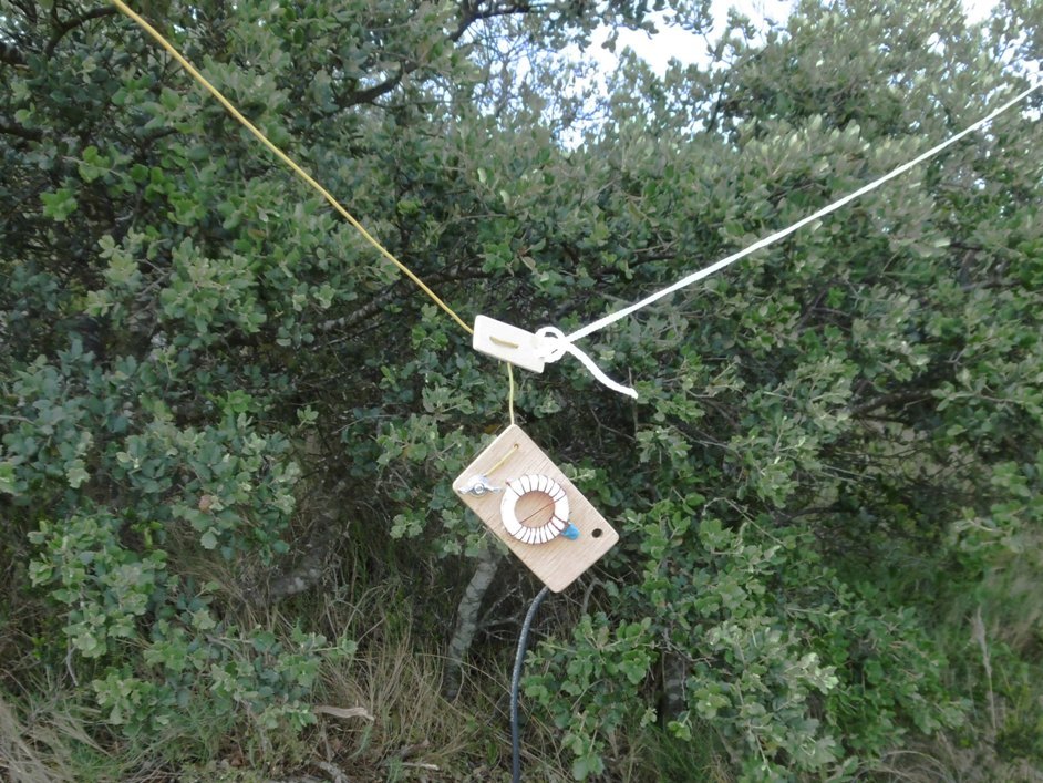

The EFHW. You can distinguish near the appex two LC traps for automatic band change (21 & 18 MHz) plus a switchable coil down the wire for 7 MHz.
Detail on the Feeder, without any box to save some grams. It is made out of a FT114-43 plus a little 150 pF capacitor in parallel. Coax is RG-174 also to save weight.
