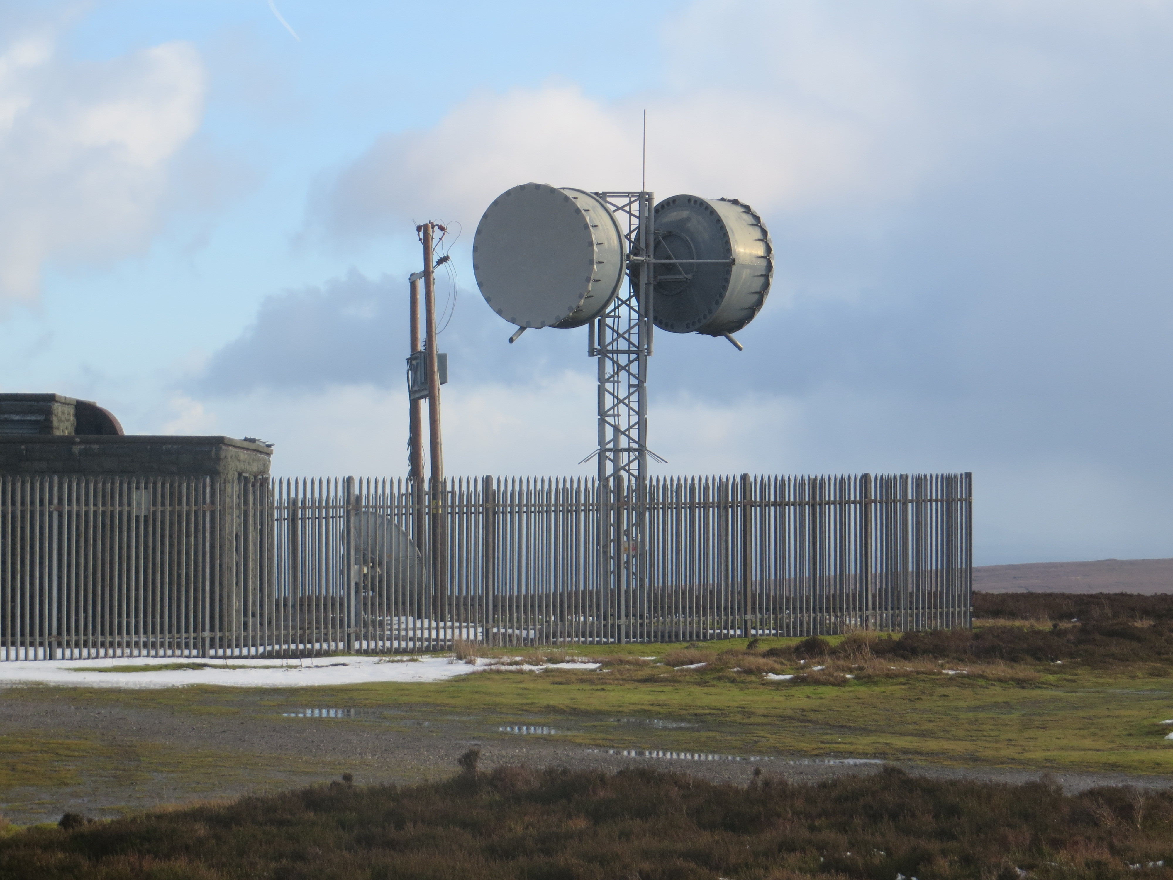

Looking at your pic of the broadcast mast and mine from 2010 shows nothing obviously VHF has been added. There are some more microwave dishes and fewer mobile phone antennas but nothing jumps out. The culprit is probably on the PMR mast which is the next one along. If you have a photo, compare it with how it looked in September 2010.
On 2m? Nope. They’re typically 4 or 7GHz and not going to cause issues. They’ve been there since 1990 as I remember anyway and I think they maybe wired back to back. i.e. passive repeater. I may be mistaken though.
The far tower (square one) is the old BT tower and all the low-microwave stuff has gone from that for years now. There’s just 23GHz and higher stuff on it by the looks of the dishes.
I can signs of new fencing where the PMR tower was on your picture. New fencing suggests someone has been doing things by the PMR tower. Unless that has been removed now.

I bow to your superior knowledge on this subject. At the summit apart from the stations we actually worked we heard nothing while others were calling us (I experienced the same on Great Orme last year). When we set up lower down towards the Ponderosa, on all 2m channels we could hear what sounded like an extremely distorted broadcast station that we weren’t able to identify, so maybe this was just a commercial vhf channel being broadcasted from the tower. I am wondering if this has anything to do with the new DAB radio stations. According to my Radio Listeners Guide there is a 5 kW DAB radio transmitter on that tower (listed as Llangollen SJ 209488) using the standard BBC muliplex frequency 225.648 MHz.
