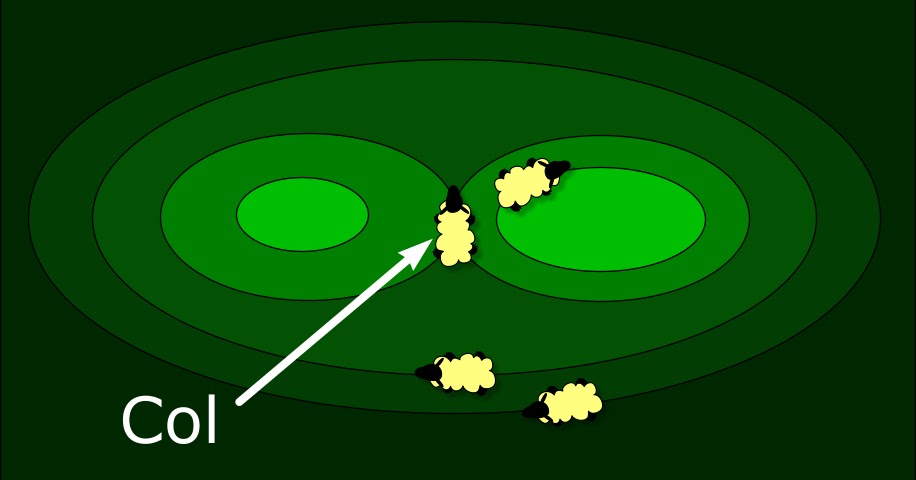

Just keep in mind that the Google elevation model is not infallible. In absolute terms it can easily be a fair few metres off even in the UK. In more mountainous areas it can be substantially worse (but perhaps not necessarily worse than local mapping). But usually the shape resembles the contours from local mapping fairly well. So always go by the summit altitude in GE rather than the SOTA database to get a relative 25-m drop in the GE model, which will likely be a reasonable approximation to real life even if the absolute values are off. In very steep terrain this won’t be so useful but when you’re up against a cliff it’s pretty obvious!
More on flooding (in the context of finding summits) here:
(and I’ll get around to finishing the follow-up posting soon)
